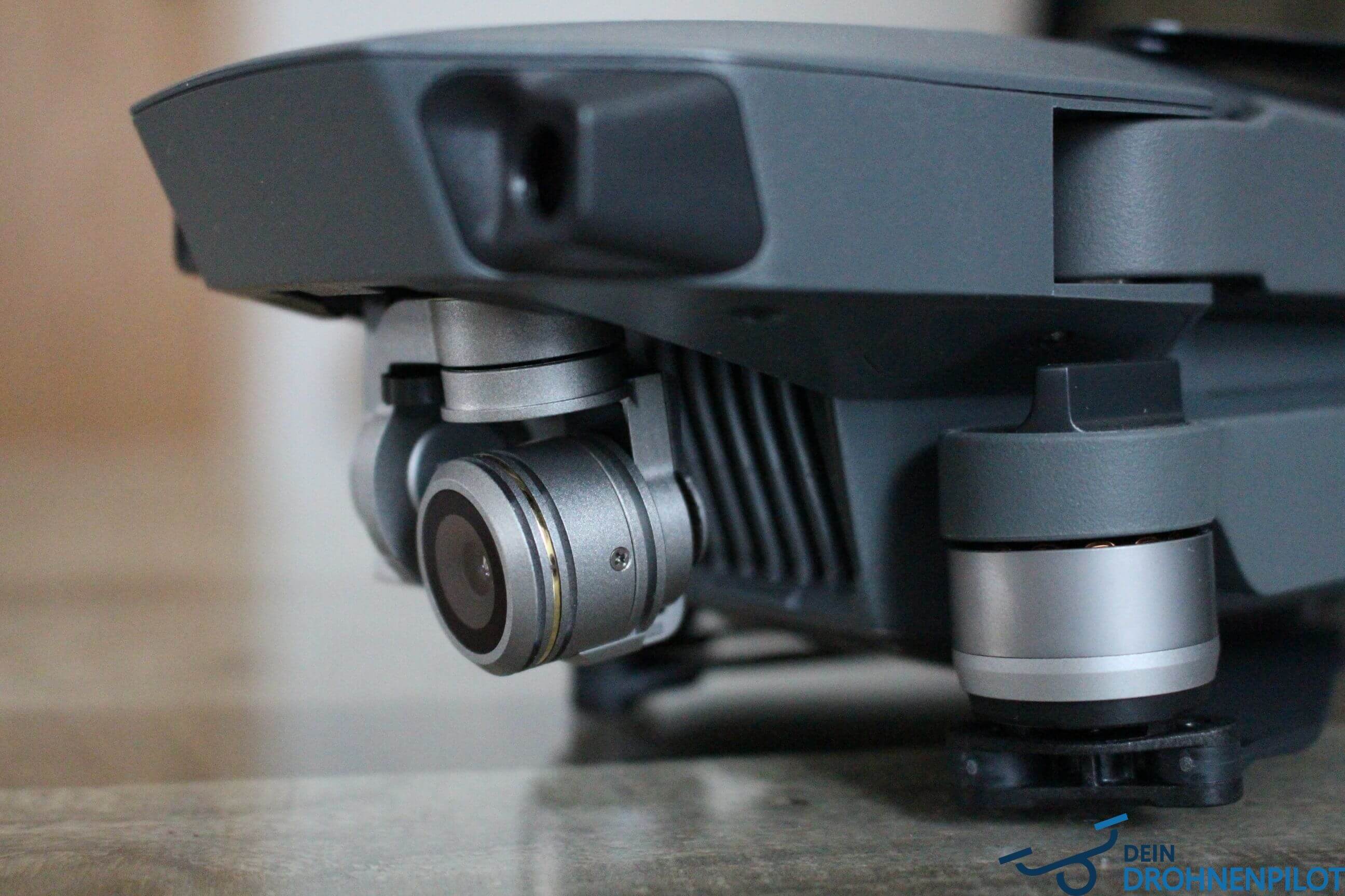

Cleaning the drone camera
A dirty lens can affect the quality of your photos to a greater or lesser extent. You should therefore regularly check that the lens is clean to ensure you get the best possible quality from your photos. A fingerprint or other dirt on the lens can be very annoying when you look at the pictures afterwards.
You have several options for cleaning the lens and quite a few people make a real science out of it. We recommend a special cleaning pen for lenses, which costs less than €7. The following procedure is then recommended.
  1. Use the side with the brush to gently remove coarse dirt from the lens. This will prevent you from scratching the lens in the next step if coarse grains etc. are still on the lens.
  2. With the other side, which consists of a velvet surface, you can now wipe over the lens without applying much pressure. Please note: do not make circular movements, but wipe radially, i.e. several times from the centre directly outwards.
In this way, you should usually be able to remove almost any dirt that accumulates on the lens over time. We can also recommend the following product.
Alternatively, we can also give you the following options for cleaning the lens.
  • Microfibre cloth and lens cleaning spray
  • handy bellows (as an alternative to a brush)
When buying a suitable blower, make sure that it is equipped with a dust filter. The dust filter prevents you from sucking in impurities when sucking in air, which you then press onto the front of your drone or the lens.
DJI Mavic Pro Kamera reinigen
When cleaning the drone camera, you should pay attention to a few points.

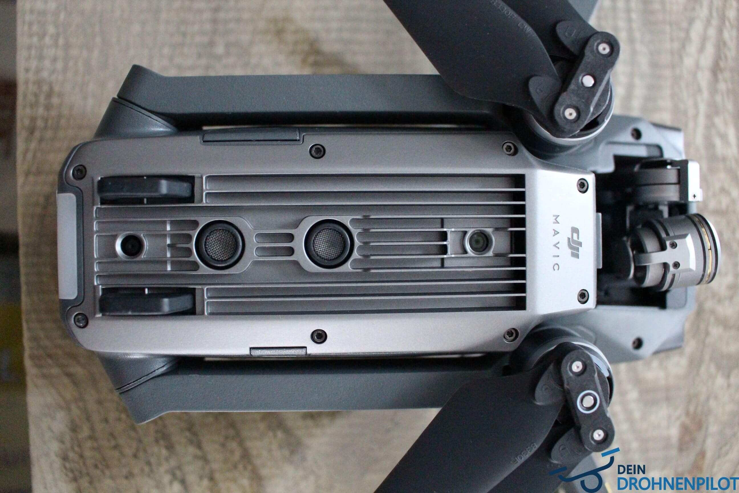

Cleaning the drone housing
Depending on the drone, the drone housing can also get dirty more or less quickly. Especially when taking off and charging on unclean ground or when flying in areas where a lot of dust or dirt is swirled around (for example in the forest), a lot can get stuck on the housing. Another common problem: insects.
Depending on the drone, dirt on the housing can interfere with sensors or block ventilation openings. As a rule, a little compressed air spray (alternatively a small bellows as used for cleaning the camera), some glass cleaner, cotton buds and a (microfibre) cloth will help here. If possible, avoid overly aggressive chemical cleaning agents so as not to damage the housing itself or any sensors. When flying the drone, make sure to use the cleanest possible surfaces for take-off and landing.
As can be clearly seen in the following image, the DJI Mavic Pro has several sensors and the ventilation on its underside. Soiling at this point can therefore impair the flight characteristics of the drone. This can be similar with other drone models. Familiarise yourself with your technology.
DJI Mavic Pro Drohne reinigen Sensoren an der Unterseite
The Mavic Pro has several sensors and the ventilation on the underside. Contamination should be removed here regularly.
