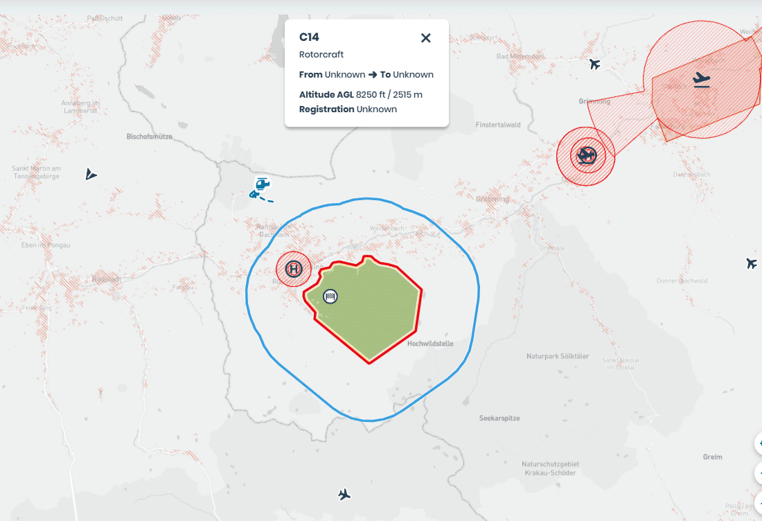

    Detected aircraft appear continuously — with category, altitude and detection source.

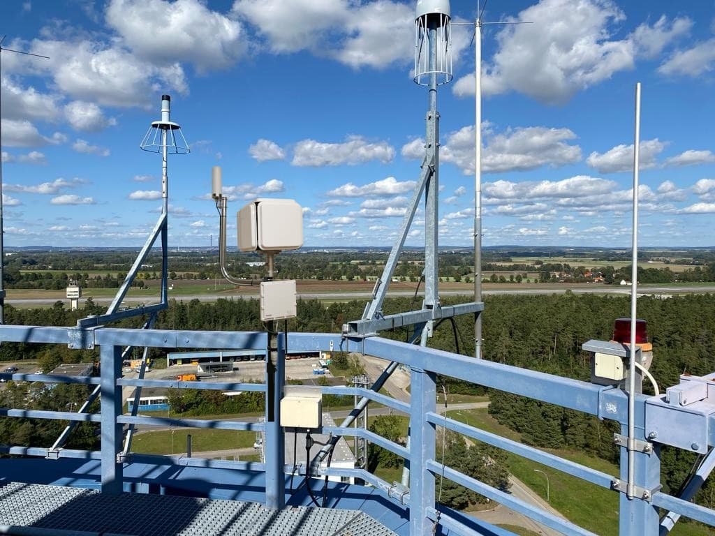

One combined antenna for 868 and 1090 MHz, under 5 W power consumption, no moving parts
Location
Desktop housing or rugged outdoor version for masts and open terrain
openAir multitrack with combined antenna

  • Who is flying, at what altitude
    Detected aircraft with category, altitude band and detection source — not just a dot on the map.
