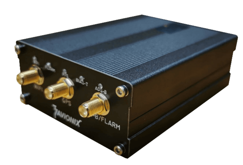

  • 01 — openAir multitrack
    All-in-one receiver for ADS-B, Mode A/C/S, FLARM, OGN, PilotAware, FANET, ADS-L and UAT978 with an integrated GNSS module. Optional, but only measurement data on site makes the report truly reliable.

One Receiver for All Relevant Protocols
The openAir multitrack detects manned aviation and drones across all common protocols – the data basis for the report.
Air protocols
ADS-B / Mode A/C/S, UAT978 (alternative), FLARM, OGN, PilotAware, FANET, ADS-L
Drone detection
Drone Remote ID via WiFi and Bluetooth — no additional hardware
Timestamps
GNSS-synchronised with nanosecond resolution — the basis for duplicate filtering and multilateration
Connectivity
Ethernet, WiFi, Bluetooth or optional 4G LTE modem
Installation
One combined antenna for 868 and 1090 MHz, under 5 W power consumption, no moving parts
Location
Desktop housing or rugged outdoor version for masts and open terrain

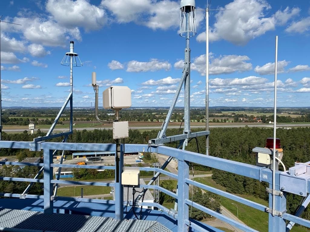

Sensor and combined antenna in the field

Data collection needs lead time. If you want to fly in summer, you need to measure in spring.
  1. Site selection
    Week 1 — plan the SORA buffer zones in wingman and choose the mounting point, with our advice.
  2. Installation
    Week 2 — you mount the receiver and combined antenna following our instructions; connectivity and reception are checked.
  3. Data collection
    Up to 3 months — continuous recording of all detected airspace users.
  4. Analysis
    2 weeks — skyzr analyses the data in wingman and produces the air traffic report.
  5. Integration
    Ongoing — our experts support your application in the Specific category.
