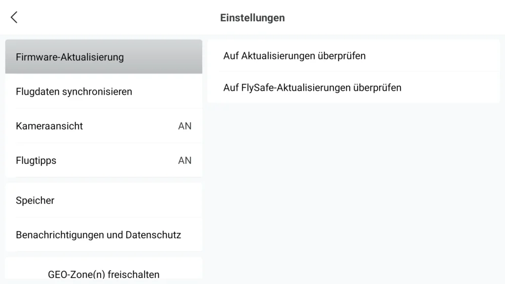

Updating the DJI Fly app
There areregular updates for the DJI Fly app. The updates not only support new drone models, but often also add new functions or, above all, fix bugs. It is therefore always advisable to install the latest version of the app.
There are also different ways of updating the app, depending on the operating system.
On your Apple smartphone, you will be shown the update as normal with all other updates in the App Store and can carry out the update.
Android users are only shown new updates in the app itself after starting the Fly app and can use this to update it.

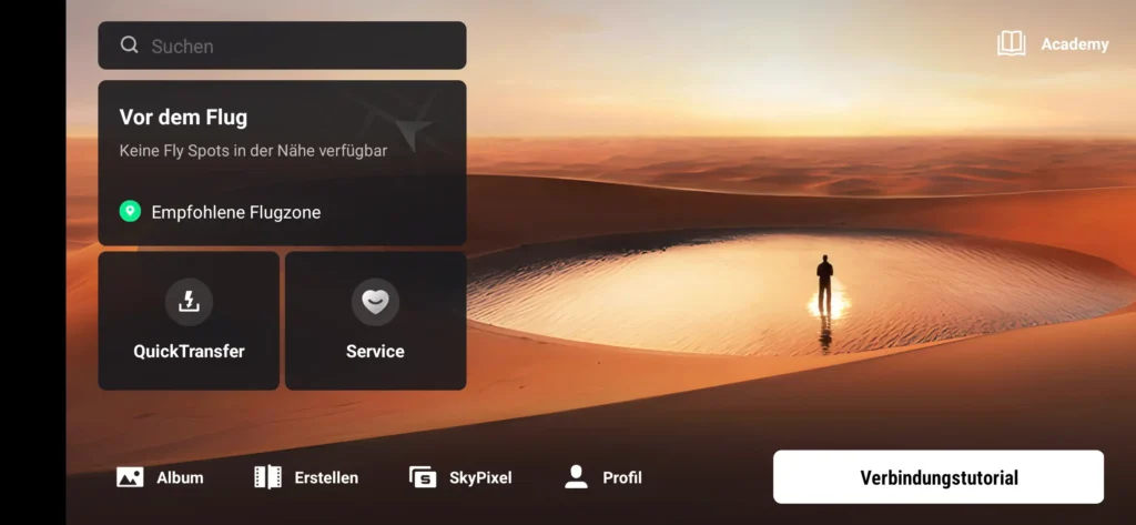

Home screen of the app
After starting the DJI Fly app, you will be greeted with the home screen. If you are not yet connected to a drone, you will only find limited functions here. You can watch tutorials from the Academy, display a connection aid, browse your album or Skypixel or switch to your DJI profile.
dji fly app home screen 2024
The new home screen of the DJI Fly app from v1.12.8
If you are connected to your drone, the view changes slightly. We’ll explain what settings options you’ll find there in the next section. At this point, we will focus on the available options on the home screen.
Before the flight
The area at the top left has only been available since Fly app version 1.12.8. This provides you with information on flight restrictions and necessary measures such as registering as a drone operator or labelling your drone. The information depends on your location or the manually selected country and is based on the official information of the respective countries. DJI has implemented an EU requirement at this point and now provides the official geo-zones of the respective country. Basically, you will receive all the important information you need to know before the flight directly in the app.
Album
You can view your previous recordings in the album. If you are not connected to a drone, you will only find the recordings on your smartphone or DJI remote control here.
SkyPixel
SkyPixel is DJI’s own photo community where you can share drone shots or view, like and comment on the shots of other members. There are also photo competitions here from time to time.
You will also find a map with fly spots maintained by the community that are particularly suitable for drone flights. You can rate them or enter additional information.

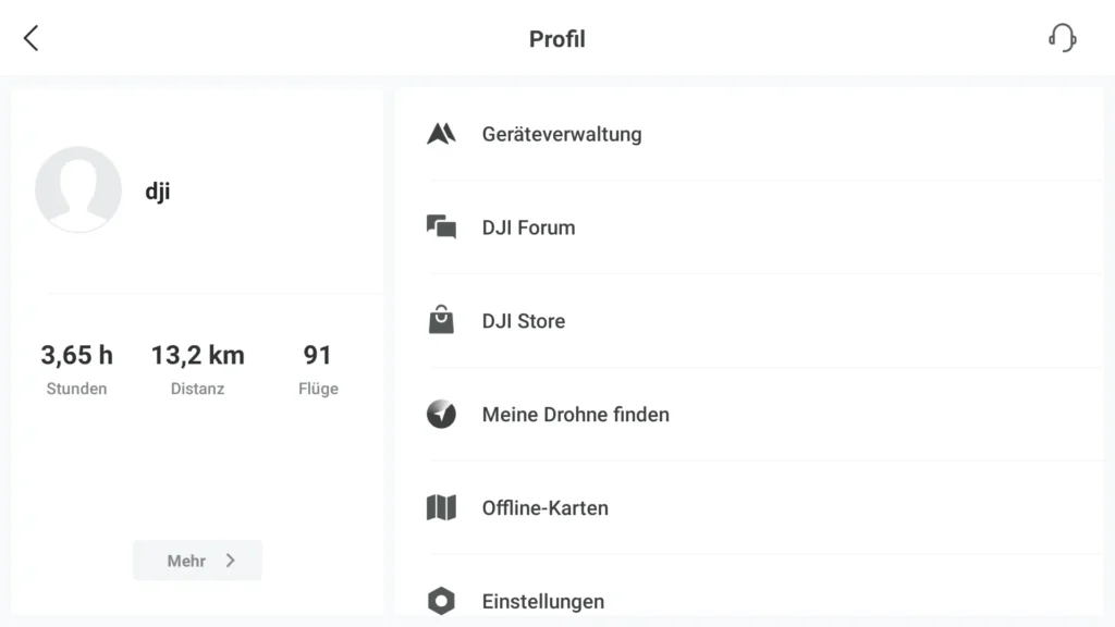

Profile
In the Profile section, you can not only view and change profile-related information – including your previous flights – but also view the currently installed Fly App version, check for updates and use the “Find my drone” function.

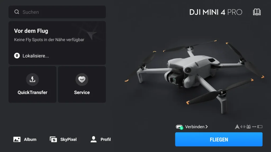

Start screen after connecting to a drone
As soon as you are connected to your drone, you will receive information on available updates in the top left-hand corner and can switch to the drone view in the bottom right-hand corner. The background image adapts to the drone you are connected to.
dji fly app home screen drone connected 2024
The start screen of the DJI Fly app from v1.12.8 with connected DJI Mini 4 Pro
As soon as you tap on Fly at the bottom right, the application switches to the flight view. Don’t worry, your drone won’t just take off after tapping the button.

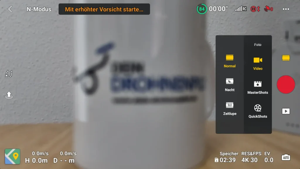

The new view consists of a large live view of your drone camera. There are also a variety of displays all around.
DJI Fly app live view with drone
At the top left, you will find information about your current flight mode. In our case, it is N mode for “Normal” mode. The flight mode setting primarily affects the maximum speed of your drone.
Next to it, if available, there are warnings with further information. You can make these visible by tapping on them.
DJI Fly App Warnings
This is followed by the current battery level of the drone, the flight time, the connection quality to the remote control, information from the drone’s distance sensors and the current number of GPS satellites to which the drone is connected.
The three points lead to the drone’s settings menu, which we will discuss below.
On the right-hand side of the Fly app, you will find various setting options for the available recording modes of the drone, the recording button and access to the saved recordings.
DJI Fly App live view with recording mode
At the bottom right, you will find information on the current camera position as well as information on the drone’s memory with an estimate of how long it can record in the current mode.

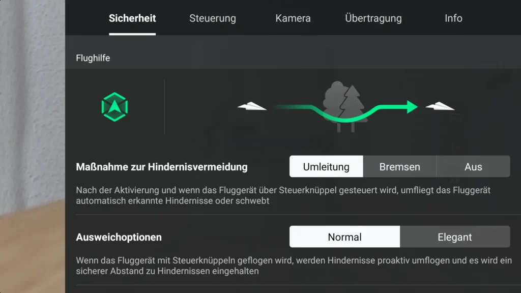

Security
The Safety section deals – surprise surprise – with all safety-related settings for the drone. It is advisable to go through these settings once and adjust them to suit your needs. At the very least, you should know where you can set what so that you can access it quickly if necessary.
DJI Fly App Security Settings
This applies to obstacle detection and obstacle avoidance, settings for the return to home function, updating the current home point (the location from which you started and to which the drone can automatically return), settings for the maximum flight altitude and flight distance, the option to calibrate the drone’s compass and IMU, battery information, settings for the additional lighting, options for activating geo-zones, the “Find my drone” function and advanced safety settings.

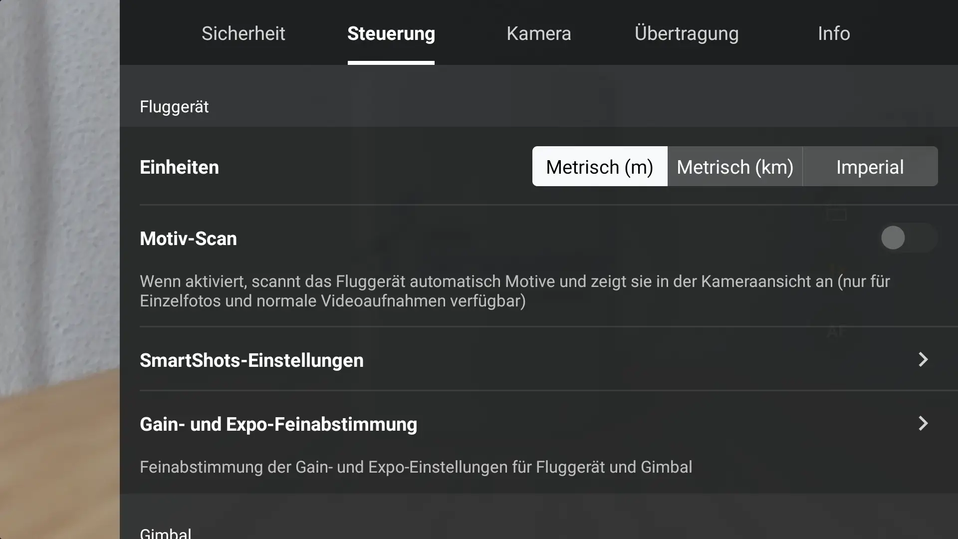

Control
DJI Fly App control settings
A very important point is the menu for setting the controls. Here you can set countless options relating to the controls. These include options for setting the units, various SmartShots settings (for example, the distances for the recording mode can be adjusted here if people or vehicles are to be tracked), each of the flight modes (Cine, Normal, Sport) can be configured individually here (e.g. maximum speeds), you can change the gimbal and control mode, calibrate the gimbal and remote control or display flight tutorials or re-pair your remote control.
